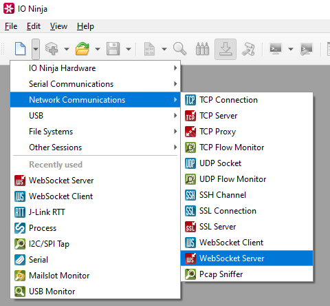

  1. In IO Ninja, click the “New Session” dropdown and select “WebSocket Server”.
_images/websocket-server-new-session.png

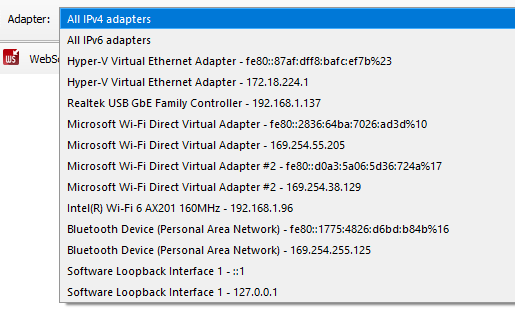

  1. Select your network adapter from the dropdown and enter a port.
_images/websocket-server-adapter.png

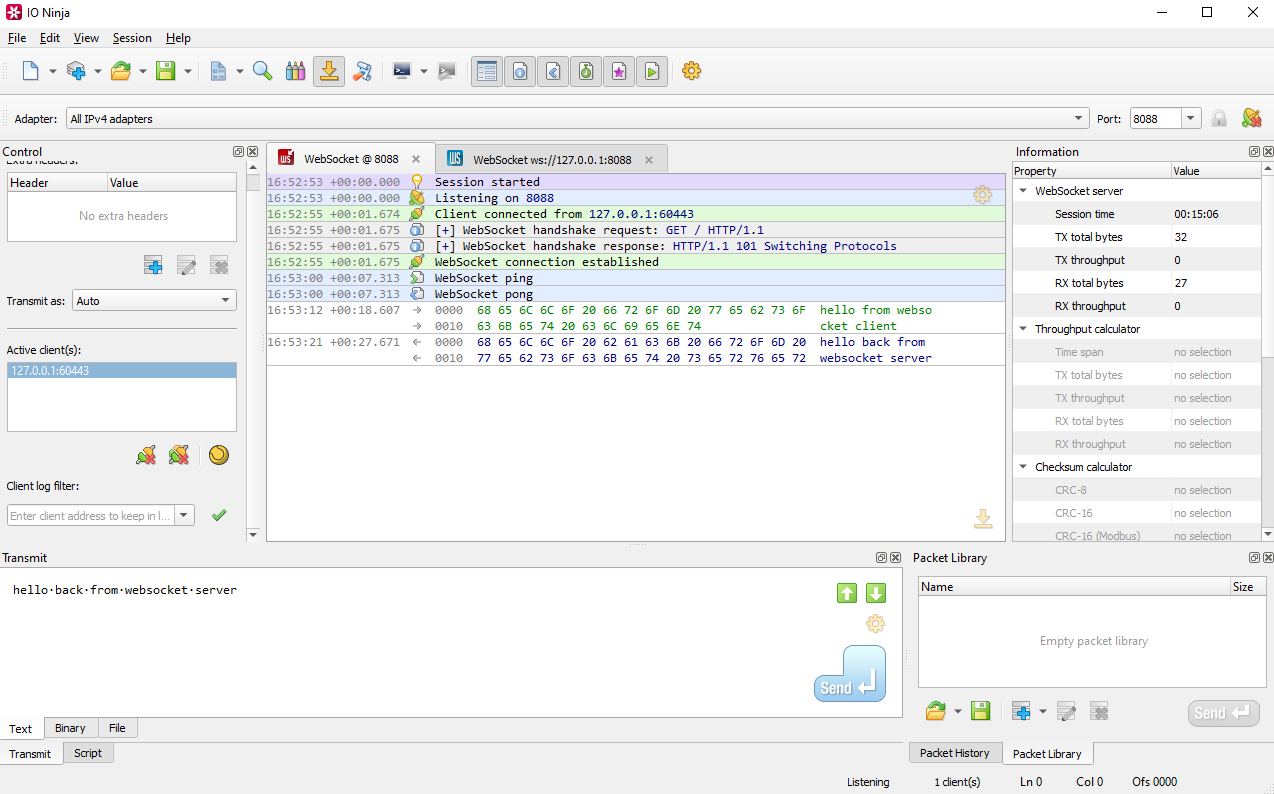

  1. Press the “Start Listening” button and wait for incoming connections.
_images/websocket-server-start.png
  1. Use the “Transmit” pane to send any packet to connected WebSocket clients.
_images/websocket-server-transmit.png

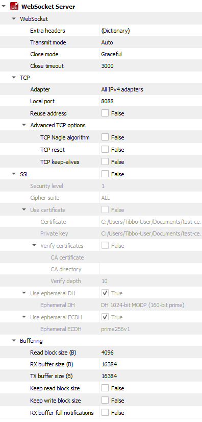

  1. Adjust settings as needed via the “Settings” button (see “Settings” section below for details).
Settings
_images/websocket-server-settings.png
Setting
Description
Default
Extra headers
Specify extra headers for the WebSocket handshake. See Extra Headers section below for more information.
Transmit mode
Specify the WebSocket transmission mode. Transmission modes determine how the WebSocket client interprets and sends messages. See available options.
Auto
Close mode
Specify the WebSocket close mode. Close modes define how a connection is terminated. See available options.
Graceful
Close timeout
Specify how long until a WebSocket timeout occurs.
3000 (ms)
Adapter
Local network adapter to bind to. Pick one from the list of installed network adapters (or bind to all installed IP4 or all IP6 adapters at once).
Auto
Local port
Local port to bind to. Setting this to 0 auto-selects an available port.
8080
Reuse address
Allow multiple sockets to share the same local address. Maps to the SO_REUSEADDR socket option. Please note, the support and details of implementation for this option are highly platform-specific.
False
TCP Nagle algorithm
Delay transmission to reduce the number of small TCP packets. Maps to the TCP_NODELAY socket option.
False
TCP reset
Drop TCP connections abruptly with a TCP RST packet. Maps to the SO_LINGER socket option.
False
TCP keep-alives
Detect connection loss with TCP keep-alive probes. Maps to the TCP_KEEPALIVE socket option.
False
Security level
Specify OpenSSL security level. Read more about OpenSSL security levels here.
1
Cipher suite
Select an OpenSSL cipher mode. OpenSSL ciphers refer to the cryptographic algorithms supported by the OpenSSL library for securing data in transit, typically over SSL/TLS connections. Read more about OpenSSL ciphers here. See available options.
ALL
Use certificate
Whether or not to use a certificate for the SSL connection.
False
Certificate
Specify the file path of the certificate.
Private key
Specify the private key for the certificate.
Verify certificates
Whether or not to verify the certificate of the target SSL server.
False
CA certificate
Specify the file path of the CA certificate to be used for verification.
CA directory
Specify a directory of CA certificates to be used for verification.
Verify depth
Specify the maximum certificate certificate chain length. A certificate chain is a sequence of certificates—starting with the SSL/TLS certificate and followed by one or more Certificate Authority (CA) certificates—that allows the recipient to verify the authenticity and trustworthiness of both the sender and the issuing CAs.
10
Read block size (B)
The size of each individual read block submitted to the underlying transport.
4KB
RX buffer size (B)
The full size of the incoming data (RX) buffer. Affects read throughput.
16KB
TX buffer size (B)
The full size of the outbound data (TX) buffer. Affects write throughput.
16KB
Keep read block size
Don’t merge read blocks in RX buffer. Incoming data blocks coming in quick succession can be merged together so that IO Ninja writes them to log as a whole. When this option is set to True, blocks are written to the log without merging, i.e., exactly as they are received from the underlying transport.
False
Keep write block size
Don’t merge write blocks in TX buffer. Outbound data blocks sent in quick succession can be merged together before submission to the underlying transport. When this option is set to True, blocks are submitted to the transport without merging, i.e., exactly as they are sent by the Transmit or Script panes.
False
RX buffer full notifications
Toggle warnings in log about the incoming data (RX) buffer getting full.
False
Note
All SSL related options only apply when connecting to a secure WebSocket. To make your WebSocket server secure, click the green lock button in the toolbar or enable SSL in “Settings”.

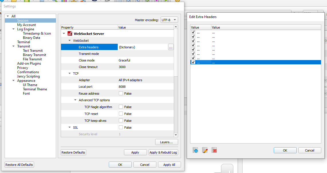

Extra Headers
The “Extra headers” dictionary is a customizable set of HTTP headers sent during the WebSocket handshake request. Each entry is a key-value pair representing a header name and its value (e.g., Authorization: Bearer token123). These headers allow the client to include authentication tokens, session cookies, custom metadata, or protocol negotiation parameters, enhancing control and compatibility with secured or feature-rich WebSocket servers.
_images/websocket-server-headers.png
