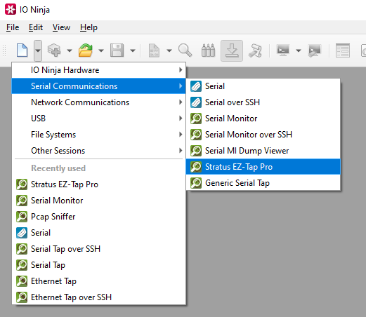

  1. Ensure your EZ-Tap Pro is connected to your serial device and your computer.
Refer to EZ-Tap Pro’s documentation for more information.
  1. In IO Ninja, click the “New Session” dropdown and select a new “EZ-Tap Pro” session.
