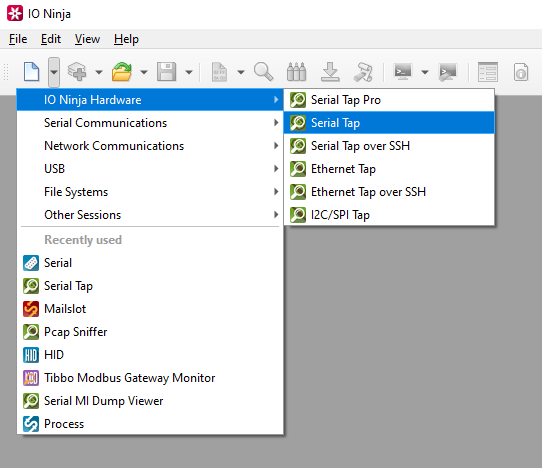

In IO Ninja, click the “New Session” dropdown and select a new “Serial Tap” session.
If not selected automatically, select your Serial Tap from the “Tap:” dropdown.
If you can’t see your tap, press the “Refresh” button.

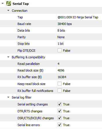

Before capturing, you should select the proper baud rate (and other serial parameters). If you need to set a non-standard baud rate, you can type it in directly to the “Baud rate” input field.

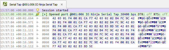

Start capturing by clicking the “Capture” button located to the right of the “Tap:” dropdown.
Monitor traffic in the “Serial Tap” tab.
Tap |
The Serial Tap that should be used. |
Baud rate |
The serial baud rate. |
38400 bps |
Data bits |
Serial data bit count (word size). See available options. |
8 bits |
Parity |
Serial parity check type. See available options. |
None |
Stop bits |
Serial stop bit count. See available options. |
1 bit |
Flip DTE/DCE |
Flip logical sides of the tap cable. All serial lines can be split into |
Read parallelism
(Windows-only)
Maximum number of read requests to issue in parallel. Having more than one pending read at a time helps with increasing read throughput when incoming data arrives in rapid streams (after filling one user buffer, the kernel can immediately switch to the next one without any waiting). Increasing this number beyond 4 usually won’t yield any extra performance gains. |
4 |
Read block size (B) |
The size of each individual read block submitted to the underlying transport. |
4KB |
16KB |
Keep read block size |
Don’t merge read blocks in RX buffer. Incoming data blocks coming in quick succession can be merged together so that IO Ninja writes them to log as a whole. When this option is set to |
Serial setting changes |
Toggle notifications about serial setting (baud rate, data size, parity, stop bits, flow control) changes in the log. |
on |
DTR/RTS changes |
Toggle notifications about control line ( |
on |
DSR/CTS/DCD/RI changes |
Toggle notifications about status line ( |
on |
Serial line errors |
Toggle warning about serial line errors ( |
on |
