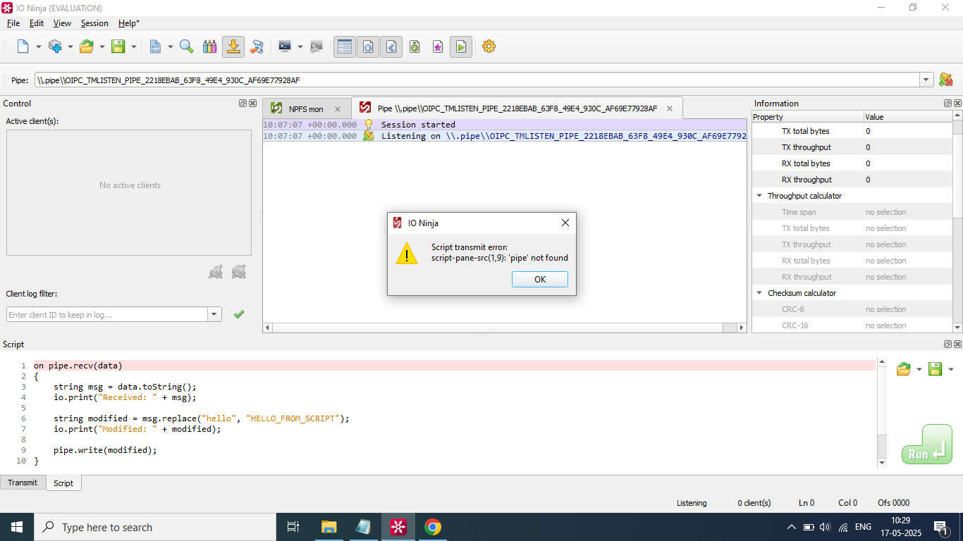

... Can I use Named Pipe Server Terminal to solve the error.. Since i m using evaluation version.
When on evaluation, you can use absolutely everything -- including Pipe Terminal and scripting.
However, the your script is not a valid Jancy script.
A simple echo script looks something like this:
void main() { char buffer[256]; for (;;) { size_t size = receive(buffer, sizeof(buffer)); transmitAll(buffer, size); } }
