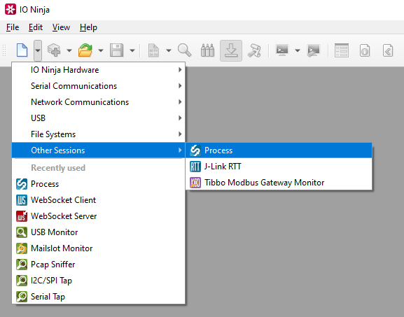

In IO Ninja, click the “New Session” dropdown and select “Process”.

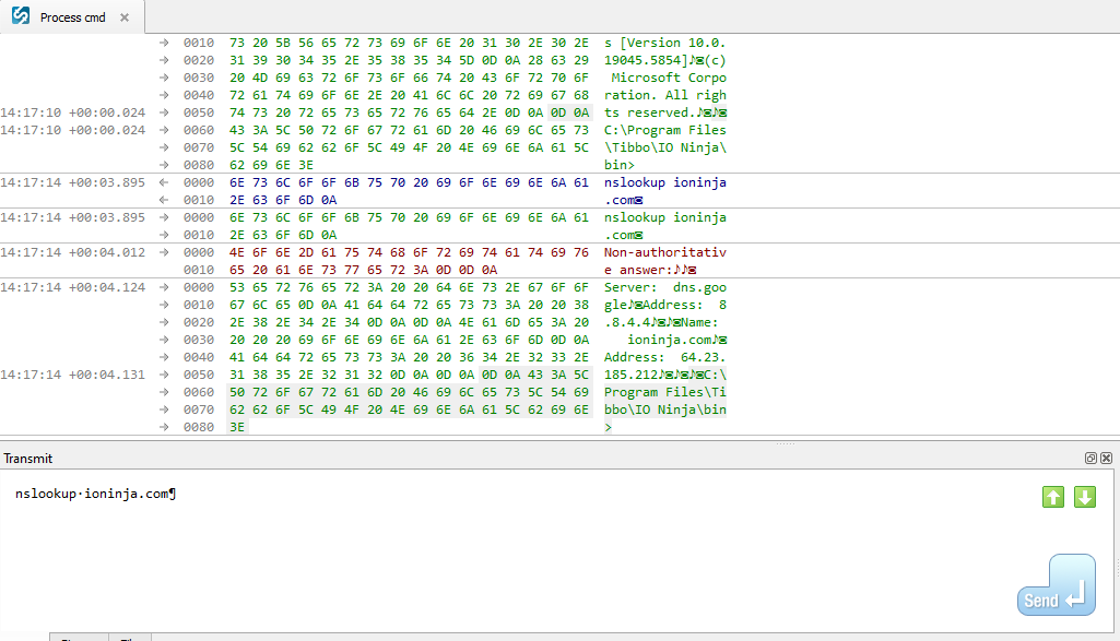

Use the “Transmit” pane to craft a custom packet, and then press send.

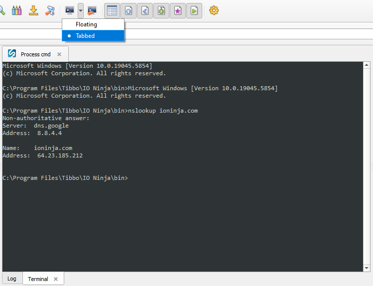

Enable “Terminal” view, and use Process just like you would any other terminal application.

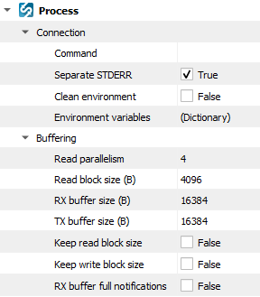

Adjust settings as needed via the “Settings” button (see “Settings” section below for details).
Note

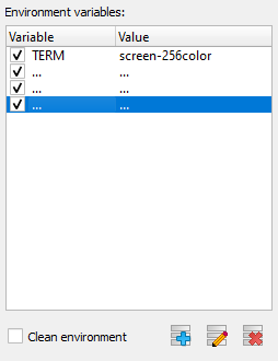

You can also add variables using the “Environment variables” section in the “Control” pane. Add a “Variable” and a “Value”, just like you would through Windows System Properties.
Settings
Setting |
Description |
Default |
Command |
Name of the process you would like to start, e.g., “cmd”. |
Separate STDERR |
Whether or not to read and display |
True |
Clean environment |
Whether or not to start from a clean environment (don’t inherit parent environment variables). |
False |
Environment variables |
Custom environment variables for the process. |
Read parallelism
(Windows-only)
Maximum number of read requests to issue in parallel. Having more than one pending read at a time helps with increasing read throughput when incoming data arrives in rapid streams (after filling one user buffer, the kernel can immediately switch to the next one without any waiting). Increasing this number beyond 4 usually won’t yield any extra performance gains. |
4 |
Read block size (B) |
The size of each individual read block submitted to the underlying transport. |
4KB |
RX buffer size (B) |
The full size of the incoming data ( |
16KB |
TX buffer size (B) |
The full size of the outbound data ( |
16KB |
Keep read block size |
Don’t merge read blocks in RX buffer. Incoming data blocks coming in quick succession can be merged together so that IO Ninja writes them to log as a whole. When this option is set to |
False |
Keep write block size |
Don’t merge write blocks in |
False |
RX buffer full notifications |
Toggle warnings in log about the incoming data ( |
False |
