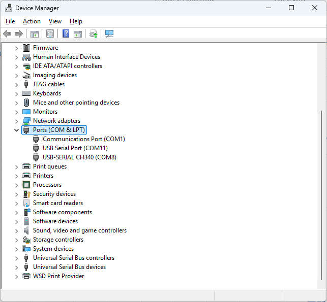

]]></description><link>http://64.23.185.212/forum/topic/334/serial-port-enumeration-incomplete-cannot-start-capture</link><generator>RSS for Node</generator><lastBuildDate>Tue, 08 Sep 2026 00:54:58 GMT</lastBuildDate><atom:link href="http://64.23.185.212/forum/topic/334.rss" rel="self" type="application/rss+xml"/><pubDate>Tue, 09 Sep 2025 18:23:05 GMT</pubDate><ttl>60</ttl><item><title><![CDATA[Reply to Serial port enumeration incomplete; cannot start capture on Wed, 10 Sep 2025 01:10:32 GMT]]></title><description><![CDATA[<p dir="auto">Greetings! The fact that IO Ninja doesn't enumerate this port on Windows means that its driver doesn't belong to the "Ports" device class:</p>
<p dir="auto"><img src="/forum/assets/uploads/files/1757466509982-db0ff6d0-24b7-47dc-990b-5c09dc0cc709-image.png" alt="db0ff6d0-24b7-47dc-990b-5c09dc0cc709-image.png" class=" img-responsive img-markdown" width="643" height="595" /></p>
<p dir="auto">Could you please share the <code>.inf</code> file for this driver? Or better yet, can you provide a download link for this virtual serial port driver so that we can play with it locally?</p>
